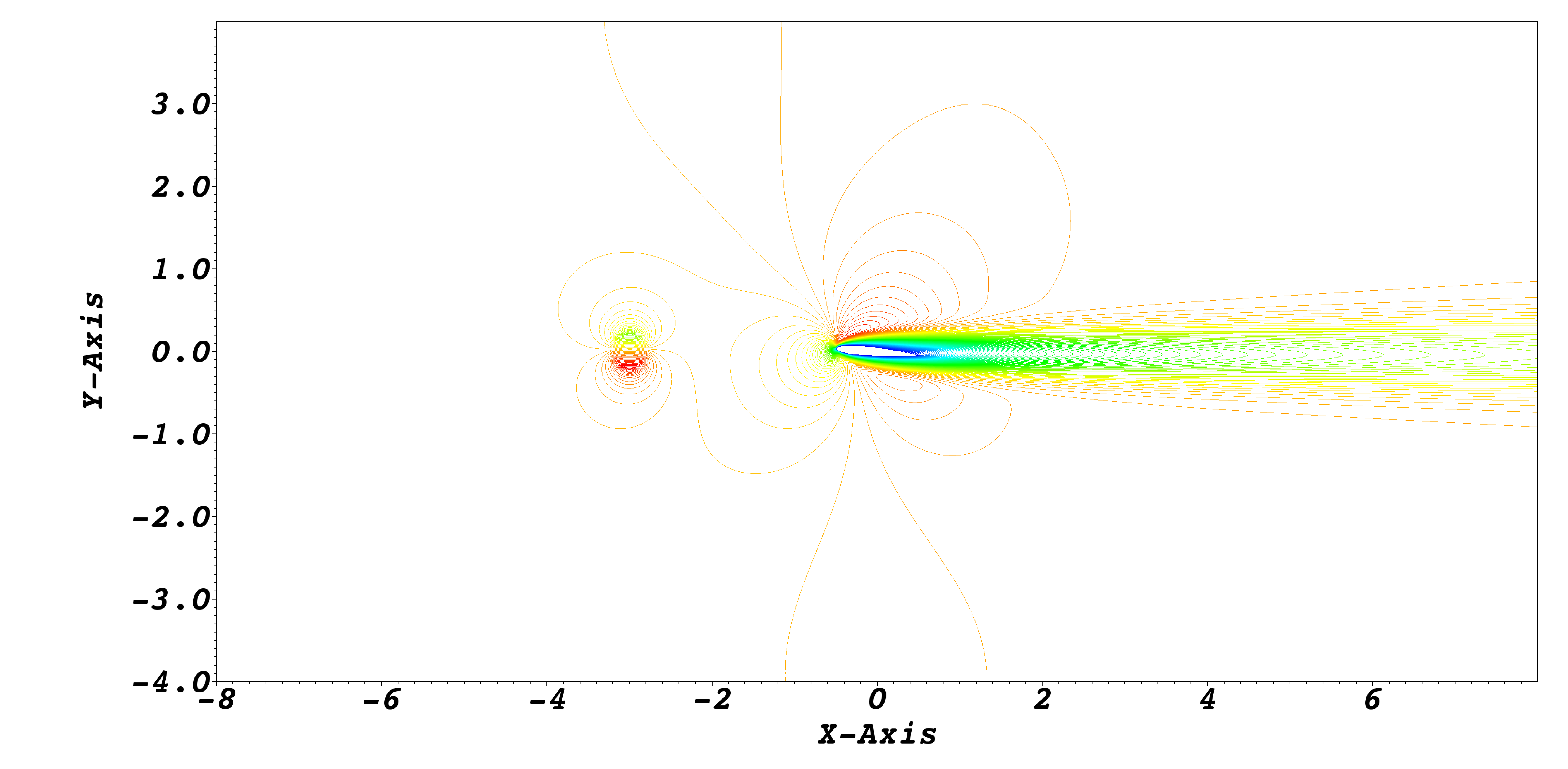

In the following, an example of the application of the zonal approach to a gust interaction problem is reported. The chosen configuration shows a vortex which interacts with a NACA0012 airfoil (see Fig. 2): several configurations with different values of vortex intensity and radius are simulated in order to build a database. The prediction error map obtained by means of the leave-one-out algorithm is reported in Fig.3. In Fig.4 the time evolution of the lift coefficient (Cl) for a configuration out of the database is reported: the results obtained by means of the zonal POD are compared with a reference high-fidelity simulations. The zonal POD simulations is repeated for different choices of the overlapping region showing how the coupling can influence the prediction error. In order to choose the overlapping region which minimises the prediction error on a given goal function, it is possible to adopt again the leave-one-out strategy during the offline analysis:
Fig.2: Interaction between a vortex and an airfoil
