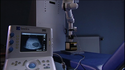

Our research aim is to optimize 3D ultrasound imaging by the use of a robotic system holding a conventional 2D ultrasound probe. The principle consists of measuring the relative displacement between each image captured by the ultrasound probe in order to position them in a 3D frame. In our approach we use a 6 degrees of freedom medical robot as the localization system and also to automatically move the 2D ultrasound probe.

The robotic task consists in automatically positioning the ultrasound image plane on a 3D fixed point materialized by the intersection of two converging nylon yarns (straight lines) immersed in a box full of water. To achieve it, we developed a new visual servoing technique based on 2D ultrasound images to control the motion of the ultrasound probe. The visual task consists in centering the two image points, corresponding to the sections of the 2 nylon yarns, on a target point indicated in the ultrasound image. It means that when the 2 image points are fused on the target, then the ultrasound probe is correctly positioned to view the 3D fixed point. As this visual task requires only 4 degrees of freedom, we use the 2 remaining degrees of freedom of the robot to reach a given probe orientations. Several positioning with different configuration of the probe allows then to identify the spatial parameters of the system thanks to a non-linear minimization technique.
